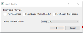

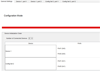

I am using the 88DK tools to configurate. I have some questions about the tool.
1. When there are two connected devices as picture shows, I save the binary the file as .bin file.
Which 988DK device can be flashed using this binary file?
Because every single 988DK matches different one EEROM, the .bin file contain the configurations of 2 devices.
Or it is forbidden to export the binary file while configuring 2 devices?
2. When exporting the binary file, which one should I choose? What is the differences between the three.
  • Hi Fabio,
    Thanks for reaching out on E2E!
    If you are flashing two different EEPROMs, you need to create a separate binary for each device and EEPROM.
    Once you are ready to flash the device, save the binary as a Full Flash Image!
    The lower region files do not contain the project configuration, that is why you must select full flash image.
    Thank you,
    Kevin
