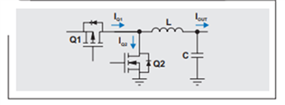

Thank you for the wonderful analysis and documentation of 48-VDC Battery Powered Inverter Power Stage Reference Design for 5-kW Forklift AC Traction Motor.
I have some queries on this design guide:
1. How R2 and R20 has been selected in figure 6.
2. Can I remove 0.5 from equation 8 & 9 if i am not using soft switching?
3. Apart from conduction & switching losses, there are other losses mentioned in MOSFET power losses and how they affect power-supply efficiency (ti.com).
But they do not comply with the existing design TIDUCB6, if i could help on the equation derived for losses other than conduction and switching losses with respect to this design, it would be helpful.
Thank you.
