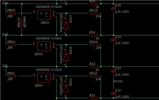

    In these boards, we have observed that the balance FETs and diodes associated with the cells that discharged to 0V get extremely hot. One other thing is that these packs are actually used in the packs that are prone to frequent heavy impact impacts. So we are considering a possibility of the arcing or something related in the cell connectors.
    Unfortunately I can't share the full schematic here. But I will attach an image of the balancing part.
    Abhijith.
  • Hello Abhijith,
    I don't see anything wrong with the cell balancing section.

    Here's the image of the AFE.
  • Hello Abhijith,
    We did notice something, the FET that you are using has a maximum drain-source voltage of 8-V and a maximum gate-source of 5-V.
    We typically use balancing FETs that have a 50-V drain-source and 8-V gate-source absolute max. Which gives a lot of room for the FET to operate correctly.
    If the ABS max is exceed the FETs can break, as to why this could've happened, it is difficult to diagnose. If an ESD strike could reach there, it could be possible that the FETs could get damaged, or possibly in events of large transients.
    I notice that you may have Vss/GND connected directly to BAT-. Does your design have a high current path for the battery current? We typically recommend using a net-tie to connect Vss to BAT- to separate the high battery currents from the IC ground. Additionally this provides a better path for ESD strikes to flow into the battery and not into any sensitive components. Can you confirm this?

  • Hey, thanks for pointing that out. I will look into these FETs. Can you also check on the diodes on the same line?
    We actually have another board with the high power MOSFETs to take care of battery currents. It's like a daughter board. We have taken care of this.
    Thanks a lot, Luis.
  • Hello Abhijith,
    The Zener diodes should be okay to leave as is.
    Ok! I just wanted to confirm that was the case. Replacing the FETs with ones that have a larger drain-source abs max would be ideal.
