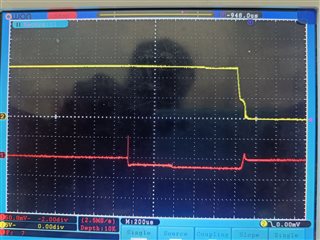

    Sorry for the late response, I did more testing but using both BQ76940 and BQ77915 both failed I have captured the waveforms from BQ76940, and from What I understand there is no Timeing oriented problem and also SCD works at 67A Current, and when I increase the current threshold to 90A it failed again. Please have a look at Waveform
    Yellow is the gate voltage
    Red is the Pack Voltage
  • Each gate already has 120R ferrite bead
  • We also captured the waveform for BQ7791501. Controlled (Connect 150A load instead of short P+ and P-)shortcircuit is working fine but when we do a real shortcircuit it is failing. We already connected the 120R Ferrite bead (HCB1608KF-121T25) on every gate.
    Current Sense Resistor - 2mR
    SCD Threshold - 60A (120mV)
    Red is the Gate Voltage (DSG)
    Yellow is the Sense Resistor
    Controlled Shortcircuit
    Controlled OCD
    Real Shortcircuit
    In this test, Mosfet got damaged
    We will wait for your reply
    Thanks for your support
    Saikat Jana
  • Hi Is waveform helpful??
    Waiting for your valuable feedback
    Saikat

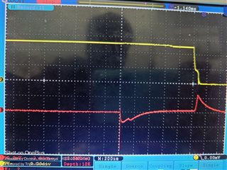

  • Hi
    Today I tried to capture more waveform in controlled SCD on the same battery and the same Short circuit setting in BMS
    Yellow is the gate(VGS) voltage and Red is the current sense(SRP-SRN)
  • Please let us know abou the images or we can capture more with battery + Voltage
    Will Wait for your reply

  • Hi Luis
    Thanks for your kind reply
    We did the testing with the same configuration as mentioned in the above Msg
    Yellow - VGS
    What we can see CHG Vgs is taking more time than DSG Vgs
    Waveform - DSG-VGS
    Yellow is the DSG-VGS and Red Is SRP-SRN
    Red is the SRP-SRN
    DSG-VGS is in Yellow and P+ and VSS in Red
    As per my understanding after analyzing the waveforms DSG Mosfet is failing due to an inductive spike in the P+ voltage. If you see the last waveform VGS in DSH mosfet is around 4V and at that time P+ is more than 62V maybe it is higher, just we are not able to capture that data.
     I might wrong. Please have a look at all the waveforms and let me know about your points
    Thanks for your support will wait for your reply as you know we already crossed the deadline and we don't have a good inventory for the MOSFET. We can do a real short circuit For 5 Times, If every time we lose the MOSFET
    Saikat Jana

  • As we thought the problem is mostly related to a spike
    The spike voltage is around 80V or More on controlled SCD
    Please have a look at the waveform and  guide us if we are moving in the right direction, also if our point is right please suggest to us how can we resolve that
    Yellow is the voltage between P- and VSS (10X) at the time of Controlled SCD
    Real Battery Voltage is around 57V
    Saikat Jana
  • Hello Saikat,
    Thanks for the waveform! Yes that is a big indication the transient damaging the FET is what may be going on.
    Your chosen FET is rated for an absolute max of 80-V across the drain-source, during a real SCD event it may be reaching breakdown because of the PACK- transient.
    There are a couple of things we could try. You could use a FET with a higher-rated drain-source breakdown voltage. We have used FETs with 100-V drain-source absolute max for our higher battery voltage devices.

  • Hi Luis
    We did more testing with 100V Mosfet (4 in Parallel)(IRF100s201) we can see the spike in P- and VSS. Controlled SCD Event Spike is around 85V and Gate turn-off time for DSG FET is around 33uS
    We don't want to increase the Turnoff Time. Is there any other way to reduce the  Spike in P- and VSS.
    What is the role of C30 and C31 connected across the FETS as per my understanding this should bypass the spike in P- to VSS
    Please let us know if we change C30 and C31 will it be helpful or if we add TVS Diode in P- to VSS(B-)
    Saikat Jana
  • Hello Saikat
    Did you still experience the burning with a 100-V FET? The higher rated FET does not remove the spike. The purpose of the FET is to be able to handle the spike. If the spike is 85-V, I imagine the 100-V FET would not get burnt.
    The only other way to decrease the spike would be to create a new layout that attempts to minimize the trace inductances as much as possible. However as I said, the 100-V FETs may be enough. We previously have recommended to use a FET rated for twice the stack/battery voltage just to ensure that it does not fail due to a high transient.
    The capacitors around the FETs are known as ESD capacitors, these provide a low-impedance path for ESD strikes to go around components and into the cell. This should not cause issues.
    Best Regards.
    Luis Hernandez Salomon
