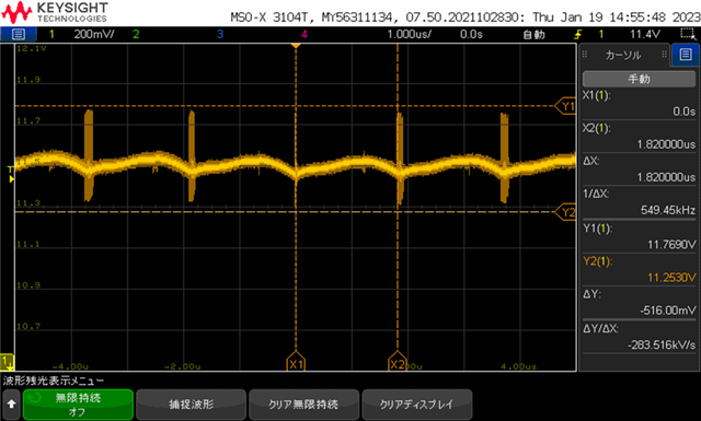

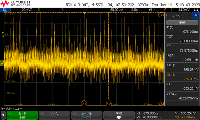

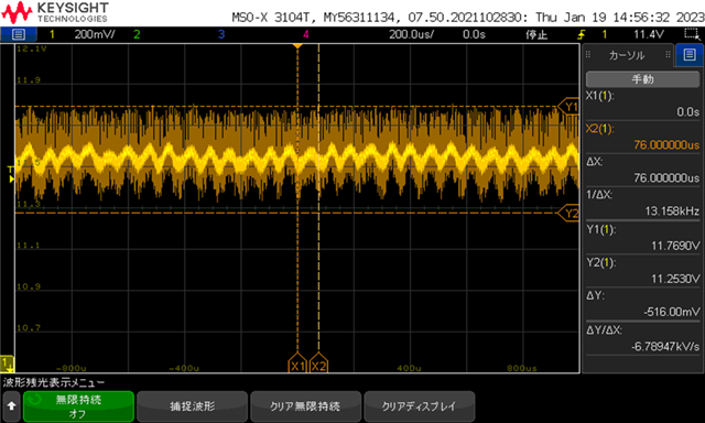

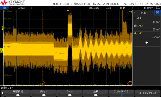

I've been testing a 12V - 3.8V application with TPS563207, and have observed some low frequency ripples at the output as below.
The switching frequency was at 500kHz( Ripple at switching frequency also exists, in the waveform of the oscilloscope it appears as spurs but if to scale up it can be seen clearly), while the noise frequency was around 15kHz. This low frequency noise has generated an audible noise on the inductor windings, which is a hard to ignore issue.

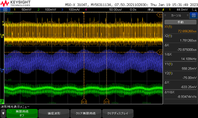

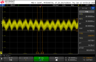

    Could you share some insights to the waveform below?
    The noise seems to exist at Vin as well.
    Vin
    SW voltage(Y) + inductor current(B) + output voltage(G)
    FB voltage
  • Hi David
    What is the input of the device? Did customer use DC source to test? Would you please share the schematic and layout?
    I will check firstly if the converter works stably. Then check whether there is any noise caused by layout. Could you find if the noise comes from the inductor of the capacitor? If it comes from the inductor, change to another inductor with different value (higher is preferred). If it comes from the capacitor, add Cout and try again. Or there is antinoise cap in Muruta.
