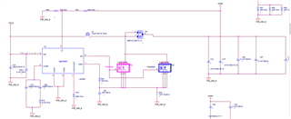

We use the LM3488 for the PSE power supply(PSE device is TPS23861), the input voltage is 12VDC, output voltage is 48VDC, the frequecy is about 200K, the MOSFET is FKBA6040, the inductance value is 15uH/ 14A;
Now, we touch the MOSFET and inductance when the power on, the temperature is more than 40℃, but we consider it is light load and this temperature is abnormal;
Please kindly review below schematic diagram and provide your comment for this design, thanks.

    Can you provide some more details:
    - what is the load when you say light load condition.
    - can you probe on some point in the circuit
      - Output voltage - check if it is stable   (measure DC and AC)
      - Switch node (between inductor, diode and MOSFET)    (should show a several switching cylces)
      - Gate signal  (should show a several switching cylces)
      - Comp pin
    How is the behavior with normal load condition?
