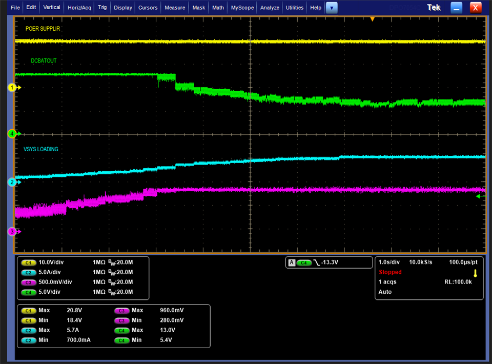

  • Hi Khalid,
    as you can see, as the load increase, the Vout drop accordingly, and IADPT remain still.
    and BQstudio shows the current limit is turned off at that moment (through EV2400)
  • HI Fred,
    The ChargerStatus shows no IINDPM triggered. If the load is too high on the adapter the adapter voltage will drop. Is it possible the input adapter can't supply this current? Can they try a lower IINDPM setting and then disable IINDPM to see if they see the exact same behavior or not?

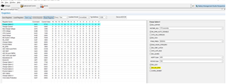

    see below , they tested again for us.
     0x12[1]=0,  but why charge status still show IINDPM triggered?
  • Fred,
    Can you ask for the sequence so we can reproduce it? Did IINDPM trigger before they disable IINDPM?
    Khalid
  • Hi Khalid,
    you can see the E-load connect at charger output, SMbus is transmitted through EV2400.
    under 4A load, the INDPM all show triggered whether 0x12[1]=0 or 1, I have video can share in Webex.

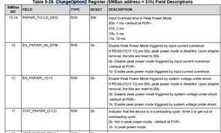

    As mentioned last Friday I would recommend the customer tries this with as many default settings on the IC as possible. I reviewed the register dump, a couple items stick out to me.
    In ChargeOption2 the EN_PKPWR_IIN_DPM is enabled per the register settings. Please keep ChargeOption2() register default to rule out this interaction.
    In ChargeOption3 the IL_AVG inductor current clamp is disabled. Please keep this register default (15A IL_AVG) to rule this out.
    Khalid
  • 1Hi Khalid,
    good news, the current limit stop after they disable EN_PKPWR_IIN_DPM.
    1. does that mean the original current limit is actually the level 2 ILIM2?
