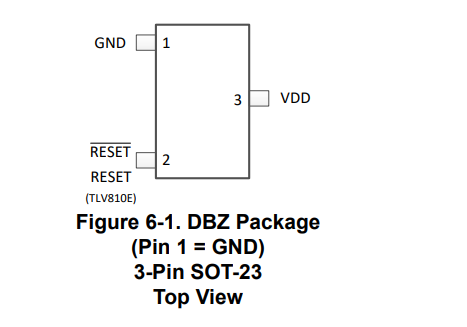

Hello Team,
have problems to identify the correct pinout for TLV803EC29DBZR.
Which pin configuration is correct?
Pin 1 = Reset
Pin 2 = Ground
or
Pin 1 = Ground
Pin 2 = Reset
Thanks.
Florian
Hi Florian
Please refer below diagram for pinout -
Trailokya

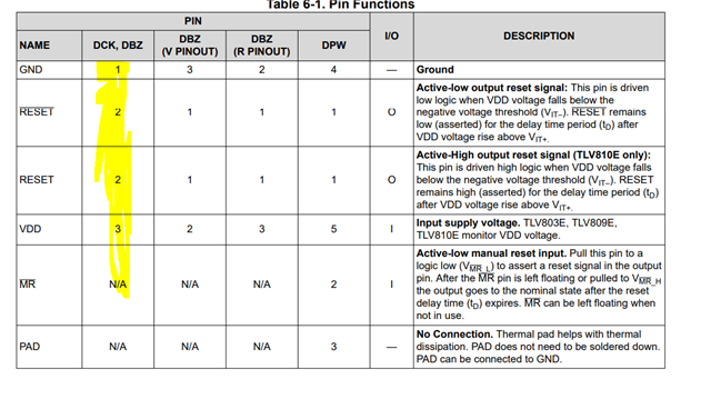

Hi Trailokya,
Thank you for the feedback.
Ok, it's not completely clear but it works with your pinout.
The datasheet says TLV810E under your picture.
Topic solved, thanks :-)
