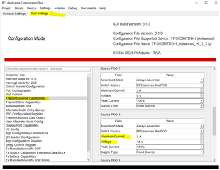

We are making a normal charger board to charge the Laptop/Tab with the output power of 65w. for that we use  the above schematic design. can u plz review the PD controller powerpath section  and also verify the the full schematic to get the desired output power, and also plz help me to the configuration setup ...
