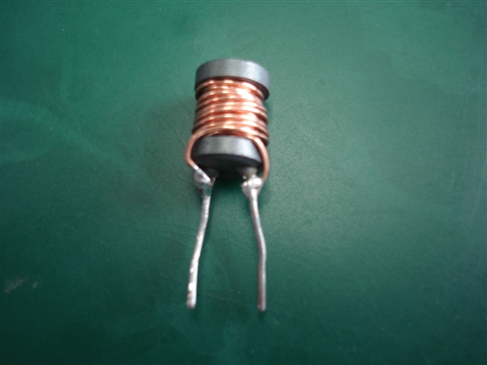

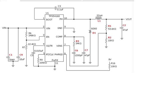

i use the tps54160 for my application, the requirements are:
Vin: 40V  Vout: 5V  Iout: 1.5A
i used the SwitcherPRO Design Tool in order to design my converter.
Design Name:
Name:  TPS54160 50-40V to 5V @ 1.5A. 06/27/2011 05:07:43  Part: TPS54160
VinMin: 40.000   VinMax: 50.000  Vout: 5.000  Iout: 1.500
so i get 5.0 volt(without load) on the output,
but when I parallel 10Ω(load) to output,
the output down to 1.0 volt,
How to solve this problem?
