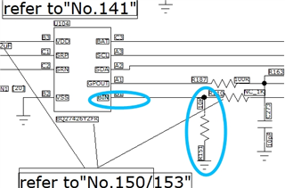

The BIN pin of our device FuelGauge is grounded.

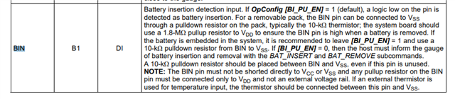

    The procedure you described is correct. You can read the temperature back to verify if the gauge accepted it or not.
    However there are other requirements that need to be met. See datasheet for more information. Here is a snippet for quick reference.

    The BIN pin on the device is connected to GND, also add 10K resistor.
    What other reasons would cause RM, FCC, SOC to become 0 after the temperature is written? Do I need to do some state judgment before writing temperature?
    Also after configuring OpConfig[TEMPS] to 10b, is the temperature the last value during the interval between two temperature writes?
  • The gauge will re-simulate a discharge if temperature changes by more than 5deg.C. If this temperature causes a significant increase in cell resistance (which is a function of temperature) and the load select is so that the gauge uses a significant discharge current, then the discharge simulation may calculate a loaded voltage that drops below Terminate Voltage immediately, thus causing 0mAh FCC and RM.

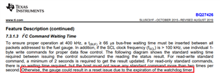

    What is the specific scenario of #2?
  • If the gauge is busy (e.g. running a long discharge simulation), and the host uC issues commands frequently (which will interrupt the discharge simulation), the discharge simulation may run too long in total (simulation time + interruptions) and the watchdog timer can expire.
  • Thank you for your support.
    Is there a description of this in TI's documentation? What are the corresponding documents and chapters?
    There is a description in the Technical Reference document as shown in the figure below, is there any other basis other than this?
  • It's in the TRM and also the datasheet:
