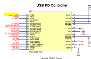

    Did you configure the USB-C-PD-DUO-EVM to provide 5A and enable the GPIO that controls the external path? When I checked the source board configuration, it looks like the GPIO is unused, so it should be using the internal power paths.
     Source Board GPIO 0
     GPIO on PD
     Power path controlled by GPIO.
    -> Using the default configuration of the board I checked with the oscilloscope that PP_EXT_EN pin is driven high when the 20V PDO is used, so the external path is enabled in that case.
