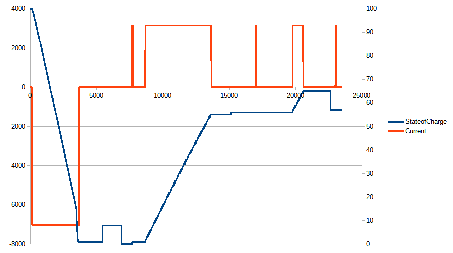

I have some funny behavior going on with the AvailableEnergy() reading with a learned pack.
Some background details:
  • I am experienced in the whole configuration process and have done quite a few different chemistries and packs now
  • TI characterized this chemistry for me because I sent in cells and had a ChemID made specifically for them
  • Chemid is 0x5857
  • 6s2p pack
  • Completed GPCRA0 and have a learned pack
  • Completed 4 Charge/Rest - Discharge/Rest cycles to dial in the RA table and Qmax
  • Everything seems to be working great

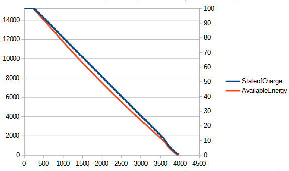

Available Energy always ends up looking like this and usually drops to zero sharply in the end. Here it didn't just because RemCap still had a few mAh left. I'm sure you get the point.
SoC and RemCap look great:
What do you guys think?
