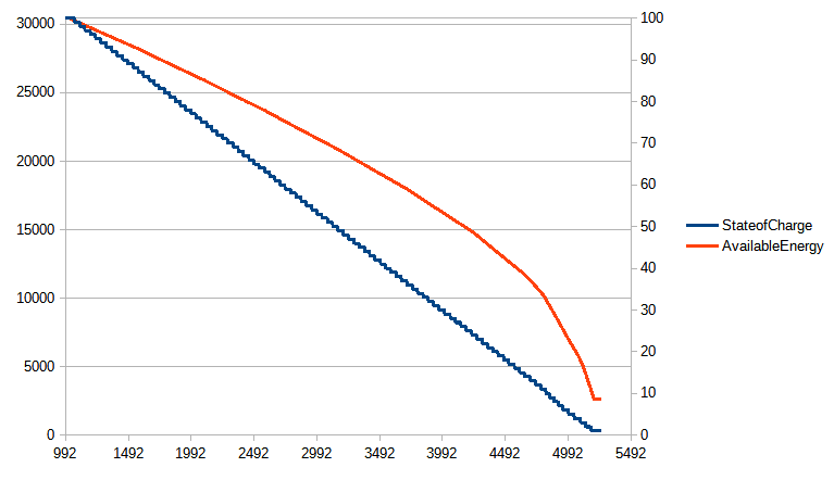

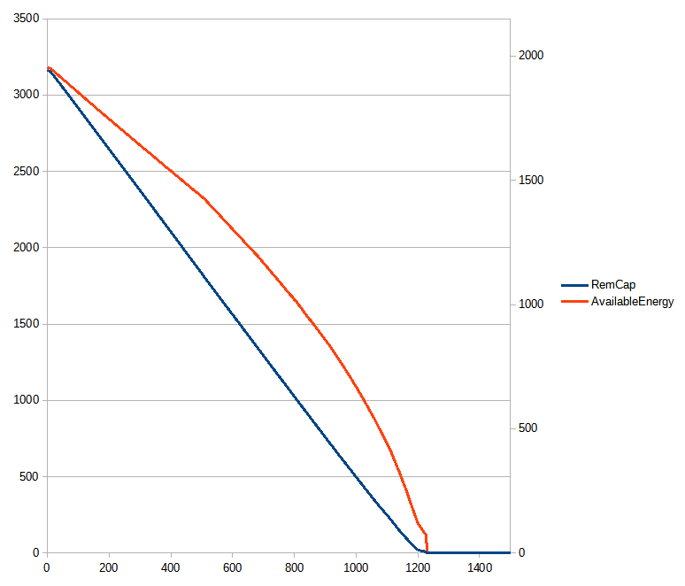

I have some funny behavior going on with the AvailableEnergy() reading with a learned pack.

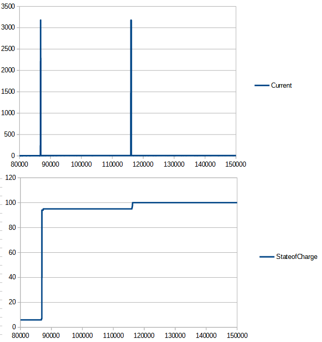

- Completed GPCRA0 and have a learned pack
- Completed 4 Charge/Rest - Discharge/Rest cycles to dial in the RA table and Qmax
- Everything seems to be working great

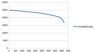

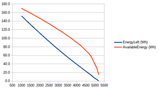

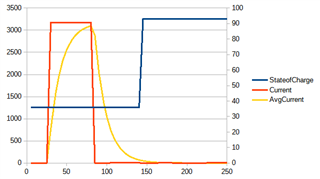

Available Energy always ends up looking like this and usually drops to zero sharply in the end. Here it didn't just because RemCap still had a few mAh left. I'm sure you get the point.

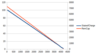

SoC and RemCap look great:
What do you guys think?
