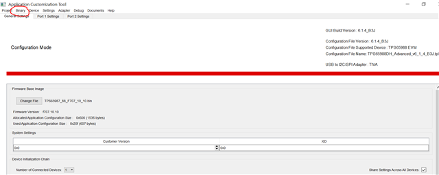

    One related thing we're working toward is securing the EEPROMs pre-programmed.  Does the application customization tool do anything special to the binary file when it programs the EEPROM?  Is it sufficient to send the distributor the binary file we use when programming through the application customization tool?
    I'd like to send you our application.bin file to review before I send it to a distributor to flash these.  What is the best way to send it to you?  (Uploading it isn't working out.)  It's not formatted in s-record style which leaves me a little hesitant to send it and go.  Is there a specific export from the application customization program that pushes out a flashable binary file if this is formatted properly for a distributor to pre-program the EEPROM?
    Adam
  • Hi Adam,
    My personal suggestion would be to not pre-program the EEPROMs since any future FW releases made to patch bugs or add functionality will have to be patched in and therefore defeats the purpose of having pre-programmed EEPROMs. Most EEPROM's typically have a way in itself to make read-only after you flash binary with some hardware changes FYI.
    Nonetheless, you can export the binary file from the GUI that has the FW patch as well as your configuration. Or you can just download the FW patch if that is what you are looking for, see steps below for how to do some from GUI:
    Click binary on the upper header:
    Select 'Save Binary' and you will get a pop up that looks like this:
    Here, you can save the low region or the full flash image, whichever you are looking for.
    For sending me the binary, I can do some prelim tests to see if binary is working as intended on one of our EVM's but can not fully guarantee operation. I will send you a friend request on how to contact me offline and send the binary. Please mark this thread as resolved and we can move this discussion offline!
