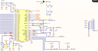

Hi Experts,
we are working on project with BQ7695202 and facing an issue.
We use 4 thermistor in the BQ7695202.
Thermistor 1 (TM1) Connect to TS1 pin,
Thermistor 2 (TM2) Connect to TS3 pin,
Thermistor 3 (TM3) Connect to CFETOFF pin and
Thermistor 4 (TM4) Connect to HDQ pin.

  • Hi Aman,
    Do you have anything else connected to the thermistor pins? Capacitors are often used to help filter noise, but the value should be less than 4nF as recommended in the datasheet or it could affect the readings. If this is not the issue, can you share the register settings for these pins?

    Here is the schematic diagram

  • Hi Aman,
    The settings look okay. The only issue I see on the schematic is that the REGIN pin capacitor should ideally be 22nF, but I do not think this would explain the issue you are seeing with the thermistor measurements. Do you think there could be a problem with the device communication? Are you reading the measurements using BQStudio or with an MCU? You are using the version of the device with CRC enabled, so that should help prevent any corrupt readings.
    Do you see any other strange measurements besides the thermistor readings? Have you tried on more than one device and are the thermistors well connected?
    Matt

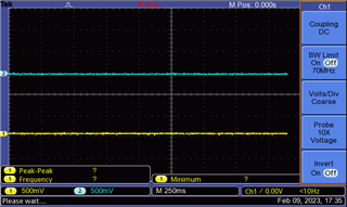

  • Thanks Aman. Please share if you are able to capture these waveforms.
  • Hi Matt,
    As you asked for waveform here are the waveforms of TS1_PIN and TS3_PIN :-
    1) When BMS behaving normal and reading accurate value of thermistor.
    2) When BMS is reading wrong value of thermistor(flat curves clearly says the reason for the same), CHG and DSG FET are in OFF condition but BMS is able to read individual cell voltages, Pack voltage, etc. AND there is no error in STATUS_A, STATUS_B OR STATUS_C Register.
    #NOTE : BMS works ok after recovery from this issue automatically after 4 minutes(approx.).
  • Hi Aman,
    This behavior is truly strange. Can you share your complete register settings? Are you putting the device into DEEPSLEEP mode?
    Matt
