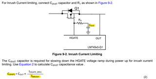

How to improve the inrush current when the system turn on?and this improvement will impact OVP and LOVP setting?
if any suggestion, Please advise me.
