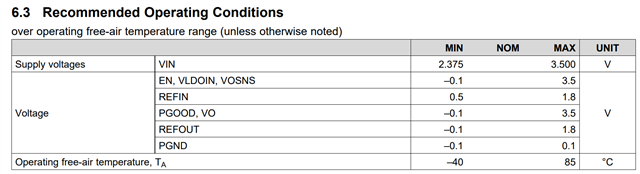

I would like to use LP2998 in the following configuration.
AVIN,PDIN,VDDQ=3.3V, VTT=1.65V output
Is it possible?
Tom
Hello, by theory LP2998 should support AVIN, PVIN, VDDQ = 3.3V and VTT = 1.65V but it is not guaranteed in the datasheet.
TPS51200 can support this application and it is guaranteed in the datasheet.
