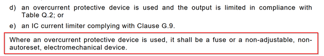

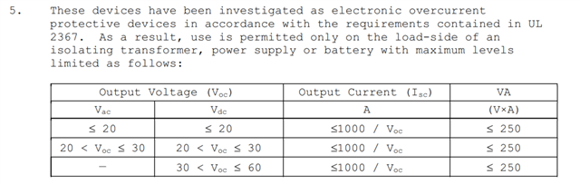

This Part is IEC62368 certified, but does is also cover implementing IEC62368 "low power source"-feature as single fault tolerant design and without any separate diagnostics?
I mean Covering IEC62368 table Q.1 limits and complying Clause G.9 as single part.
