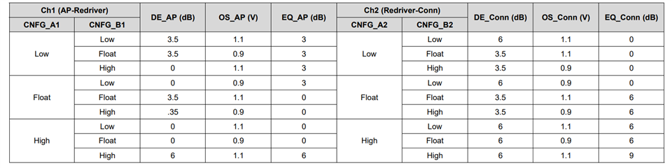

I know linear redriver tends to be placed  to connector as close as possible.
but looks like TUSB542 is limited one (DE is always >0),
so is there a distance limit between connector and redriver to prevent over-compensation.
    The De-emphasis setting must be set based on the length and characteristics of the post channel (channel after the TUSB542 device). And the corresponding RX will then adjust its EQ to compensate for the remaining loss as part of the USB link training.

  • Hi David,
    let's say compliance short-channel test which means basically not cable condition, and the pre-channel loss is well-compensated.
    if we place it very close to connector, it might potentially get over-compensated( since we don't have 0dB DE option)
    so in that case, can we decrease the AP_EQ to prevent it or we just place it not too close to connector?
    You can use the spreadsheet to calculate the trace length between TUSB542 and the connector, but I would agree with you that you do not want to put TUSB542 next to the connector.

  • Hi David,
    just want to check with you that this DE spec at TX budget,
    does this mean it's the DE dB power that  required by the other side of connector,
    so for short channel case as example, I should input 0dB since there's no cable loss(no need for compensation) expected at connector side, right?
    but what if long channel compliance , what should I input for long channel compliance scenario?
    *** Correct, the is the DE that is required by the device. So we took the max DE the TUSB542 can support, subtract the PCB parasitic loss, subtract the required DE to come up with how much DE margin we have left (Max TUSB542 DE - Parasitic loss - required DE).
    *** No, remember the device can adjust its EQ during link training. So for short channel case, it will reduce its EQ. For long channel case, it will increase the EQ if the TX DE (in this example, 3.5dB) is not enough.

  • Hi David,
    thanks for your explanation yesterday,
    all this question actually is because
    I was worried about over-compensated(DE too strong) in short channel case even device side tune its EQ to completely 0 already,
    but judging from our discussion yesterday, looks like in practical case it's actually quite hard to failed the eye diagram with the whole channel being over-compensated ,
    am I right?
    It depends on how much the signal is over-compensated. The eye will not be fully closed if there is a little over-compensation.
