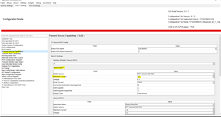

    If you are in PD mode acting as a power sink, you will want to adjust the Transmit Sink Capabilities register:
    If you are in PD mode acting as a power source, you will want to adjust the Transmit Source Capabilities register:

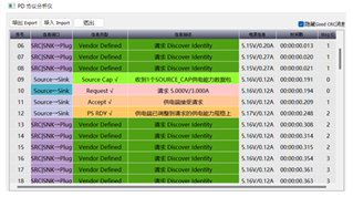

    We use the Power-Z KM001C to see what's going on, and below is the picture we catched.
    - Fail and Re-detection:
    -Success for the first time:

  • Hi Jimmy,
    Can you try increasing the Operating Current Value to 1.5A?
