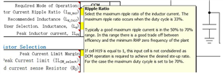

Q2: in LM51551 SEPIC calculation excel, there is a ripple ratio parameter. when i calculate max inductor ripple current, should i use 0.33 in this input box or other value?
pls share your valuable comments.
