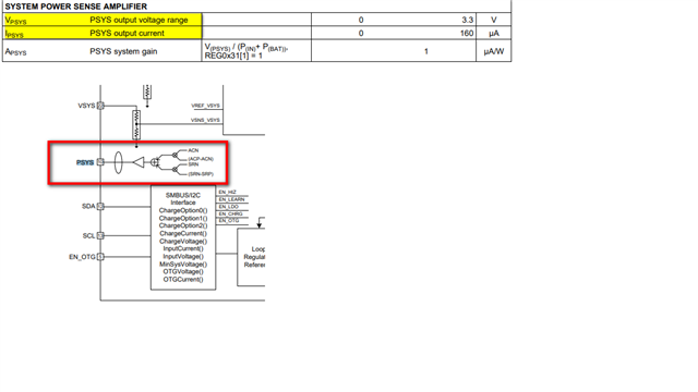

    In addition, please ask BQ25703A pin 10 Psys
    1. Is the output a voltage (VPsys) or a current (IPsys) that needs to be converted into a voltage through an external Pull-Down resistor?
    2. What is the maximum wattage of the report? (Ex: 160W)
  • Hi Gareth,
    the PSYS output is a current signal based on the PSYS equation. It generates a voltage drop on the PSYS resistor. The voltage is clamped at 3.3V. Sizing the RAC/RSR current sense and PSYS resistor, you could design for 160W applications without reaching 3.3V clamp.
