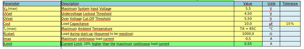

I'm working with a design based in the tps26620 for a backup source with a supercapacitor.
The design was done through the design calculator tool and the schematic and the settings values are:
The circuit doesn't work, the efuse latches off intermediately its enabled. According to the datasheet, this behavior is due to an overload or a thermal shutdown.
In the calculation tool I could see a possible error:

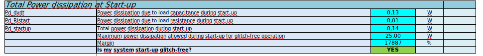

 The Cout value it is set in 10uF when its should be 10F, when I try to change the units it's not able so I try with the equivalent value (10000000). Under the original conditions, the system has no problem with power dissipation in the startup time.
But when I change the Cout value, the system has problems with power dissipation. After some changes in the calculator I got a stable system with the following values: Cout 2000000uF and Cdvdt 100uF. (The other parameters are the same.)
When I probe the circuit with the news values, the efuse doesn't latches off, but the FLT pin in the efuse is in low state for a long time. This time (tdvdt) is too long for the efuse to get the rated voltage, but it is enough to charge the supercapacitor, then I have to turn off the efuse to prevent an overvoltage in the supercapacitor, as a consequence the efuse will never get the rated voltage and the FLT pin will always be in low state.
On the other hand, the inrush current is about 10A in the original design and about 1A in the final design.

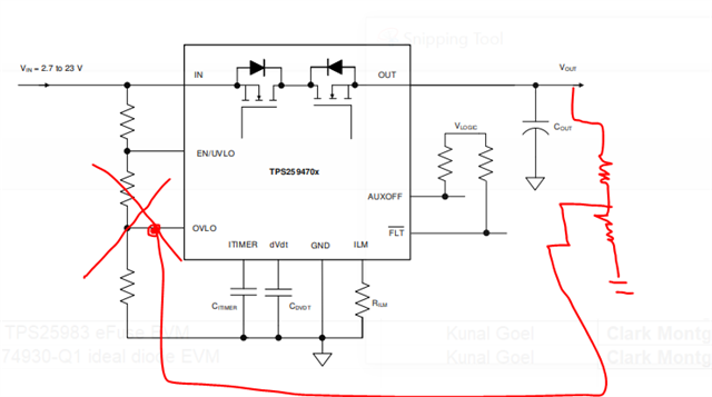

  • Hi Christian,
    You can tie output voltage to OVLO pin through resistor divider. This way when VOUT crosses 3V eFuse will turn off and supper will not charge beyond 3V.
    Kunal Goel

  • Hi Christian,
    You will have to use another device with lower UVP. Please have a look at TPS25947 device. You will have to use a minimum VIN of 2.7V for this device.
    You can use like this:
    Kunal Goel
