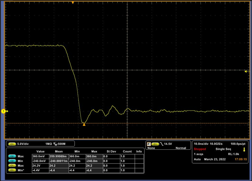

Hi team,
Please take a look at the following waveform, seems big undershoot, looks like the perod of less than -3.5V for 5ns.
Datasheet section 7.1 specified that SW-PGND less than 100ns transients -3.5V to 38V. based on this, this is spec violation.
Please let me know, and give me some advice how to improve undershoot.
