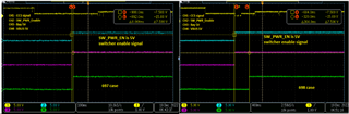

    The delay that i mentioned is observed during a plug event. When the plug event happens we are enabling the switcher which generates the 5V and there is a delay is observed between the voltage availability on the PP_HV1 and VBUS1.
    For the 987 the delay is around 18ms
    For the 988 the delay is around 340ms.
    Please let me know if any other data is required.

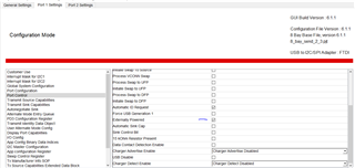

    Whether the check and uncheck of externally powered in the port settings affects any delay? Currently we are providing external power to both chipsets from a 3.3V switcher. But , for one chipset i.e 988 bin we have checked the Externally powered (in which we are seeing more delay in VBUS release) and for the other one i.e 987 we have unchecked the externally powered(in which we are seeing less delayed in VBUS release).

    Also when I was checking at the GUI I found an another difference on the configuration file version.
    For the 987 part is 6.1.2 and for the 988 part it is 6.1.1. Can you please let us know what is this actually and whether it can make any difference in the functionality.
  • Hi Sai,
    After talking to a systems engineer, there should not be a difference between the timing between the two devices. Do you see this timing difference consistently on all of your 987 and 988 PD controllers?
    Can you provide scope captures of the VBUS and PPHV showing the timing issues you are seeing?
    The latest GUI version is 6.1.3, and will have the latest firmware patches. I would recommend moving to the latest firmware as it will have the latest bug fixes. You can find it on the ti.com product page.

  • Hi cristoper,
    Thanks for your reply. Currently i am checking with the 6.1.3 verison of GUI.
    Apart from that please find the images of the probed waveforms.

  • Hi Sai,
    Are you using different projects between the two EVMs?
    We noticed that there is activity on the CC lines during the "delay", which indicates that the 988 may be in a slightly different configuration.
    Can you share the pjt files you are using. Please see if there are any differences between the two projects at the "Type-C supported options" in Port Configuration.
    Also, are these being tested with the same load?
    Thanks and Regards,
