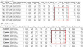

  • Hi Shirish:
    There has newest tested result which is not good for customer.
    Please refer these attached files, that are log file and gg file.
    0216.xlsx
    0217.log.xlsx
    20230218_statham checked.gg.xlsx
    I have a lot of questions which shows in the ppt.
    checked results_statham.pptx
    Please help to check these files and provide your recommendations for us.

  • Term voltage is set at 2800mV in the gg.csv
    I am not seeing the voltage drop below that in the ppt graph
