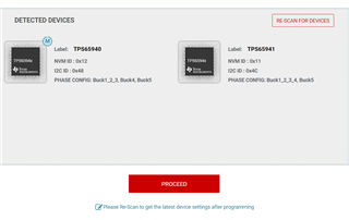

I'm facing problems with the bring-up of the TPS65941212EVM + TPS65941211EVM boards.
The two boards are stacked up, Vin = 3,3V, USB connected to master TPS65941212EVM.
All jumpers left at the state of delivery.
Immediatelly after connection the following message appears:
Both devices appear as can be shown below:

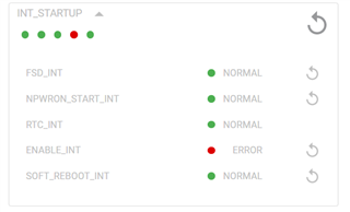

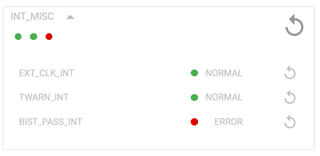

All Buck Regulators remain off and the status registers can be seen below:
Which steps do I need to follow do to get the BUCK Converters up and running?
