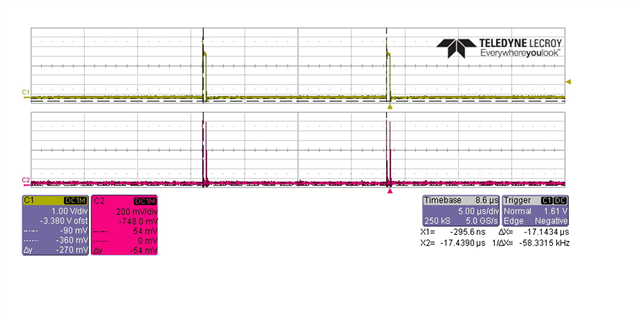

    below impedance measurement (device not powered) on the broken device:
    L1 to GND :0.9Ohm
    L2 to GND :0.8Ohm
    Vin to GND : open circuit >3MOhm
    Vout to GND : 0.7MOhm rising (I see output capacitors charging, the multimeter is charging the capacitors )
    Oscilloscope measurement on the same part
    C1 Voltage measured on L1 (Vin=4.5V)
    C2 Output voltage Vout=0.035V
    Switching frequency measured 58KHz

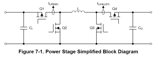

  • Hello Tao,
    I show you my impedance measurements on L1 and L2 on the broken TPS63900 Inductor removed from circuit:
    L1 (PIN9) to Vin => Open (2Mega Ohm)
    L1 (PIN9) to GND => Open (2Mega Ohm)
    L2 (PIN7) to VIN => Open (2Mega Ohm)
    L2 (PIN7) to GND => Short (1Ohm)
    L2 (PIN7) to VOUT => Open
    According to the "Power Stage Simplified Block Diagram" shown on the part data-sheet it seems to me that Q3 is broken.
    I will make the same measurements on the other broken parts.
    Any hint on how this could happen?
    Best regards
    Jan
  • Hi  Jan,
    thanks for your great work.
    yes, you are correct, the Q3 may demaged and mostly it is caused by the high spikes during the switching.
    with 4.5V input, device should always work in buck mode and there will be no switching in node L2, because Q3 is always off and Q4 is always on.
    so here i suspect two root cause as bleow.
    • input is bulit up with a small slew rate, then, during start-up, device may run into Buck-Boost mmode.
    • there may be some oscillation at the output, since there are many caps far away from device, i think it is resonable and we can confirm by adding some more caps near the device.
    Tao
  • Hi Tao,
    many thanks for your help I will follow your advises.
    I have analysed the other two broken parts in the same way. They are broken in a different manner:
    Part2: Vin 4.5V, Vout 0.04V, I input = 176mA
    L1 (PIN9) to GND => 5Ohm
    Part 3: Vin 4.5V, Vout 0.5V, I input = 3A (Power supply limit)
    The input power supply voltage drops to 2.5V because in is limited to 3A (I assume that this changes the switching behaviour and it tries to go to boost mode)
    L1 (PIN9) to Vin => Short
    L1 (PIN9) to GND => 10Ohm
    L2 (PIN7) to VIN => 11 Ohm
    Do these measurement confirm you failure root causes?
    Thanks regards
    Jan
