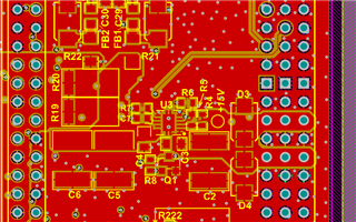

I am deisgning industrial electronics board with TPS26620 at the power supply input and hot swap does not always work. I managed to destroy two out of three identical boards. Somehow, SHDN pin gets almos short  cut with Vin pin (there is only 40Ohm between SHDN and Vin - in new, not used chip this resistance is in megaohms). SHDN pin is not used (R8 and Q1 are not populated) and line between Q1 and SHDN pin is 10mm long. Before burnout, I experienced big difference between VIN and VOUT even with no consumption at the output. I expected "smooth sailing" with TPS26620.

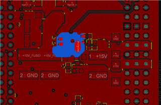

    Here is how my PCB looks like:
    PCB is 6L, these are top and bottom layers. Layers 2 and 4 are GND (not connected to RTN).
    This is just top layer:
    My RTN plane area is around 0.5cm2 and just on the bottom. Do you think that can be an issue?
    I mean, the current is too small to burnout the chip. When I place my finger on the chip I do not sense heating.

    6. I took an empty board and started soldering component by component. First eFuse and its components with only 20nF at the output. Then I added 2x470uF and repeated tests - first turning on the laboratory power supply, then hot plug to the powered backplane. I tried hotplugging with and without big caps 20 times (or even more) and there were no failings.
    Then I took a populated board on which I burned eFuse yesterday, soldered a new chip (with Cdvdt=1uF) and repeated tests which I performed on the board with only eFuse and surrounding elements and everything was ok. I noticed that on all burned chips pin 6 (GND) is welded to the PCB pad, so I destroyed that pad during unsoldering damaged  eFuse.
