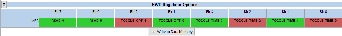

    • First, enable the REG1 regulator (set REG0 Config = 0x01, REG12 Config = 0x0D to set REG1 to 3.3V)
    • In the Enabled Protections C register, set the [HWDF] bit to enable this protection.
    • The time for this protection to trigger can be set in the Protections:HWD:Delay register. I set this to 5 seconds for this example.
    • In the HWD Regulator Options register, set the [TOGGLE_OPT] bits to ‘10’ and the [TOGGLE_TIME] to ‘0101’ (see below image)
    • Finally, disable the Dashboard in BQStudio (see image) to stop communication from the PC. This will cause the watchdog timer protection to trigger after 5 seconds and REG1 will turn off. Then after 5 more seconds (because of the TOGGLE_TIME bits), REG1 will turn back on.

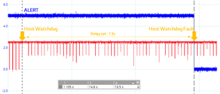

    Is the problem that when you put the BQ76952 into Shutdown mode, it will accidentally reset the MCU? Then maybe the Alert pin could be used. The Default Alarm Status register allows the Alert pin to signal if the device is going into Shutdown (SHUTV bit) or if a HWDF has occurred (SSBC bit).

    Q1. According to your guide, we tested and could find ALERT Activation after host watchdog fault (below picture)
    but, problem can't return to original status because it is impposible to clear host watchdog fault (due to communication fail status)
    It cause repeated reset of MCU. is it way to return ALERT siganl in host watchdog falult status?

  • Q1: No, there is not a way to clear the ALERT signal without MCU communication.
