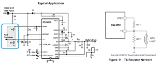

RESISTORS AT TS PIN
It was considered the use of the thermistor 103AT-2, and a safety charge temperature from 0°C to 45°C
RTHcold(°0C) = 27.28K
RTHhot(°45C) = 4.911K
VREF = 3.3V
VLTF = 73.5% of VREF (3.3V) [typ] = 3.3*0.735 = 2.426V
VTCO = 45% of VREF (3.3V) [typ] = 3.3*0.45 = 1.485V
RT2 = ( VREF * RTHcold * RTHhot * ( (1/VLTF) - (1/VTCO) ) ) / ( (RTHhot * ( (VREF/VTCO) - 1)) - ( RTHcold *( (VREF-VLTF) -1 ) ) )
RT2 = ( 3.3 * 27280 * 4911* ( (2.426) - (1/1.485) ) ) / ( (4911 * ( (3.3/1.485) - 1)) - ( 27280 *( (3.3-2.426) -1 ) ) ) = 82083 Ohms
RT2 commercial = 82K
RT1 = ( (VREF/VLTF) - 1 ) / ( (1/RT2) + (1/RTHcold) )
RT1 = ( (3.3/2.426) - 1 ) / ( (1/82000) + (1/27280) ) = 7.374K
RT1 commercial = 7.5K

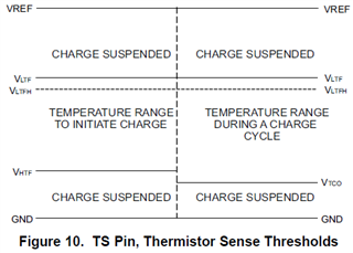

    Resistors at TS Pin - My only comment would be to take into account VHTF, which has a slightly narrower region to start charge. Please check that the commercial resistors yield the desired TS settings.
    Ok, you say about Figure 10. I understand. Noted.

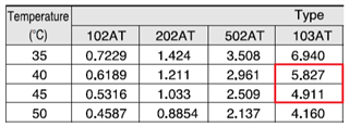

    RESISTORS AT TS PIN (RECALCULATION)
    My equations for calculating RT1 and RT2 were wrong, now they are correct. And you can see at the end that considering the values of RTHcold and RTHhot of thermistor 103AT-2, and considering the calculated values of RT1 and RT2, the low temperature (ºC) and high temperature (45ºC) thresholds match voltages VLTF and VTCO.
    VREF = 3.3V
    VLTF = 73.5% of VREF (3.3V) [typ] = 3.3*0.735 = 2.4255V
    RT2 = ( VREF * RTHcold * RTHhot * ( (1/VLTF) - (1/VTCO) ) ) / ( (RTHhot * ( (VREF/VTCO) - 1)) - ( RTHcold *( (VREF/VLTF) -1 ) ) )
    RT2 = ( 3.3 * 27280 * 4911* ( (1/2.4255) - (1/1.485) ) ) / ( (4911 * ( (3.3/1.485) - 1)) - ( 27280 *( (3.3/2.4255) -1 ) ) ) = 30115.15 K Ohms
    RT2 commercial = 30K
    RT1 = ( (3.3/2.426) - 1 ) / ( (1/30000) + (1/27280) ) = 5.147 K Ohms
    RT1 commercial = 5.11K
    Calculating back:
    RT1 = 5.11K
    RT2 = 30K
    (1) low temperature threshold.
    30K // 27.28K = (30*27.28) / (30+27.28) = 14.287K
    3.3V * ( 14.287K / (14.287K + 5.11K) ) =
    3.3 * ( 14.287 / (14.287 + 5.11) ) = 2.43V (very close to VLTF...)
    (2) high temperature threshold.
    30K // 4.911K = (30*4.911) / (30+4.911) = 4.22K
    3.3V * ( 4.22K / (4.22K + 5.11K) ) =
    3.3 * ( 4.22 / (4.22 + 5.11) ) = 1.49V (very close to VTCO...)
    VHTF = 47.5% of Vref [typ] = 0.475 * 3.3 = 1.5675V
    3.3 * ( x / (x + 5.11) ) = 1.5675
    x = 4.6235K (parallel of thermistor and RT2)
    30K // y = (30*y) / (30+y) = 4.6235K [x]
    y = 5.466K
    VHTF (calculating back)
    30K // 5.466K = (30*5.466) / (30+5.466) = 4.6235K
    3.3V * ( 4.6235K / (4.6235K + 5.11K) )
    3.3 * ( 4.6235 / (4.6235 + 5.11) ) = 1.5675 (match voltage of VHTF)
    So, when the resistance of the thermistor is 5.466K, the voltage at TS pin will be equal to 1.5675V, which is the typical voltage VHTF. Datasheet of the thermistor:
    5.466K is between 40 to 45ºC. It is something about  40.5°C to 42.5°C (max) to be able to initiate a charge, and 39~40°C would be enough.

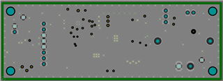

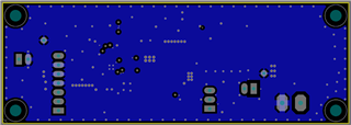

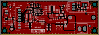

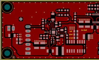

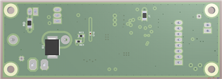

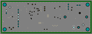

  • Hi Jeff.
    Here is the updated schematic and pictures of the initial layout.
    Also is attached the spreadsheet with calculations of the resistors for the ambient temperature compensation with the NTC 103AT-2.
    Question: In case of reverse polarity at the input of the PCB (up to 60V reverse), for D7, on MPPSET pin, would it be good to use a very low VF, ultra-low leakage shottky diode? -0.3V is the maximum absolute negative voltage at MPPSET pin according to the datasheet of BQ24650. Or maybe, to multiply the values of resistors RP2 (68K) and RP3 (4.7K) by 10 times? To 680K and 47K?
    PCB-NB3-A_sch_03.pdf
    Geo_MPPT_NTC_103AT-2_solar_panel_Resun_RSM060-P_-mppTrackingWithBQ24650AndNTCthermistor.xls
    L1: Top Layer
    L2: Ground Plane, 0.18mm below L1 (Top Layer)
    L3: Signals and GND filling
    L4: Bottom Layer, 0.18mm below L3
    Top Layer ground
    Do you have some observations to make?
    Regards.
  • All copper layers will have 1oz thickness.
  • For good EMC performance, the negative of input filter capacitors, negative of low-side transistor, and negative of output filter capacitors should form a local ground with a star connection, and then connect to the ground plane, no?
    Regards.
    Can you please confirm what second temperature you are using to calculate the temperature coefficient so I can verify the calculation?
    In the event of reverse polarity you need to protect all pins connected to the input (in your case MPPSET, VCC, STAT1, and STAT2). Please see Figure 16 which shows a diode D1 to protect for "reverse voltage protection for the VCC pin."
    My layout review is as follows:
    1. It does not look like there is a separate analog GND and power GND. Please see the separation in Figure 15 in the datasheet and Layout Guideline 7.
    2. We recommend in Layout Recommendation 2 for the "gate drive signal traces kept short for a clean MOSFET drive." I believe it would help to shorten the gate drive traces. See our layout in the BQ24650EVM.
    Mike Emanuel
  • Hello Michael.
    Thanks very much.
    Basically I understand ,(1) there is not a separation between analog GND and power GND and (2) gate traces are not short.
    Soon I will be able to work in this layout again, then I will check carrefuly.
    Regards.
  • You are welcome. I look forward to hearing from you!

    Here is the NTC compensation calculator (for the ambient temperature of the solar panel). I have entered my inputs, I just would like to input a voltage drop of 0.1V (in D3), but the spreadsheet says that this cell is locked. Then when I try to unlock it I'm asked about a password that I don't know.
    1667.Geo_MPPT_NTC_103AT-2_solar_panel_Resun_RSM060-P_-mppTrackingWithBQ24650AndNTCthermistor.xls

    6. Do you intend to have a TS thermistor connection? If not, you need to adjust the divider for TS.
    Yes, I do pretend. The calculator shown this values (in yellow):
    I have used 5.11K and 30.1K on the schematic (components RT1 and RT2). This is the TS of the battery.
    For the temperature compensation with NTC (for the solar panel), the user of the PCB has the option to use or to don't use the NTC compensation, placing a jumper on connector NTCSEL, placed between 1-2 (no use of NTC) or between 2-3 (using NTC), that's the idea.
    Please share your comments.

    6. Here is what is missing. The TS pin of the BQ24650 requires 103AT-2 thermistor attached in parallel with the bottom resistor if the above calculations are used. This thermistor goes on the battery and measures the battery temperature. This is separate from the MPPSET thermistor on the input of the device. If battery temperature monitoring is not required, please bias the TS pin at 50% of VREF.
    Mike Emanuel

    6. Here is what is missing. The TS pin of the BQ24650 requires a 103AT-2 thermistor attached in parallel with the bottom resistor if the above calculations are used. This thermistor goes on the battery and measures the battery temperature. This is separate from the MPPSET thermistor on the input of the device. If battery temperature monitoring is not required, please bias the TS pin at 50% of VREF.
    "This is separate from the MPPSET thermistor". Yes, I know about this, we can have up to two 103AT-2 thermistors in the system/board. Only the MPPSET thermistor is optional, the one which monitors the ambient temperature of the solar panel, in order a temperature compensation can be made for the MPPV.
    One thermistor will be always present, which is the one present inside the Li-Ion polymer, always present, there will be no situations where we will not sense the temperature of the polymer, there will be always a 103AT-2 inside the polymer pack, and its 2 connections are made, until now, according to the picture below.
    I wonder if the NTC ground connection can not share the ground connections of the battery connector, just because the NTC ground connection would need to be connected to the analog ground. If this is true, then the battery connector, which has 7 pins, will need to have an extra pin, to be able to connect the ground connection of the NTC (which is internal to the polymer) directly to the analog ground, and not to the power ground. At first, I think that changing the connector from 7 to 8 pins will not be an issue.
    UPDATE: If according the datasheet, RT2 of the picture above (or R10 of picture below), the resistor to ground (of battery TS), it does need to be connected to the analog ground, hence the NTC ground connection must also be connected to analog ground, so I will modify the battery connector to be 8 pins, but regarding this part, I will send updated schematic about this only in a next post.

    Below, pictures of the current layout.
    3D - Top
    3D - Bottom
    Layer 1 - Top
    Layer 2 - Ground plane
    Layer 3 - Power plane + Analog ground plane. The clearance/separation between the planes is 1.3mm.
    Layer 4 - Signals and ground fill
    Layer 5 - Ground plane
    Layer 6 - Bottom
    I have a doubt, C7 and C8, their ground connections are currently connected to power ground, should they be connected to analog ground instead? Picture Below.
    Thanks and regards.
    My schematic review is as follows:
    1. Please do the required gate resistance calculations to see if you will be able to drive your switching FETs. Too much gate resistance and you will not be able to switch the gates fast enough.
    1. It does not look like the non-VCC side of R13 is connected to anything. It looks like it is floating.
    2. Please connect C7 and C8 to analog GND.
    If you have further reviews, please send me the Altium file or Allegro file so I can view it. Its is not easy to see all of the traces as separate images.
    Mike Emanuel
    We could produce the first prototypes, with the gate resistors using jumpers.
    Fixed this.
    Ok. Done.
