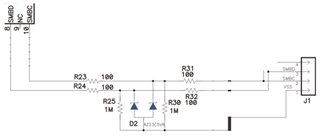

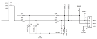

I now design a project, bq40z50 pin SMBD and SMBC connection, as shown in Figure 2; During the customer host test, it was found that it could not communicate with the host;
The connection of another SMBD and SMBC is shown in Figure 1; Communication is normal. Can you help me introduce the advantages of the two connection modes?
I check the recommended circuit of bq40z50, which is also designed according to Figure 2;
Figure 1
Figure 2
thank you!
  • Hello Zherong,
    I would need to see the waveforms measured on the gauge SMBus pins to see. When you test with EV2400 does it work well? Does the host have pull-up resistors? The EV2400 has built in pull-ups, if you do not have these on your host side the communication will fail.
