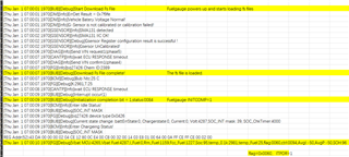

The FuelGauge does not load the FS file when it is first powered up. It takes about 4 seconds to complete the initialization (INITCOMP is set to 1).
Why does it take 4 seconds?
What is the exact operation that FuelGauge performs in 4 seconds?

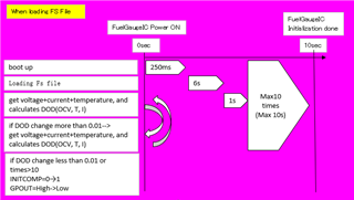

  • Thanks for you reply。
    #1-#3:
    step1:boot up-->250us;
    step2:get voltage+current+temperature, and calculates DOD(OCV, T, I) -->1 sec;
    step3:if more than 0.01,recty step2。Maximum 10 times(Max 10 sec)
    Is the above understanding correct?
    #4: Can DOD be stable during fs file loading? The actual test situation is that after the fs file is loaded, INITCOMP=1.
    #5:After loading the fs file, the ITPOR in Flag() is not cleared, and there is SOFT_RESET instruction at the end of the FS file. What is the reason for this?
    Is there any restriction when FS file is loaded?
  • #1-3: Yes.
    #4: The gauge will check DOD after receiving a reset (e.g. SOFT_RESET)
    #5: The SOFT_RESET command will eventually cause ITPOR to clear.

    #4 When Fuelgauge is powered up, it starts loading the fs file, is the following process correct?
    #5 During the test, after loading the fs file, ITPOR is always 1, and I can't make ITPOR=0 by sending SOFT_RESET command manually.
    #6 Is there a limit to loading FS files? What is the limitation in the loading process?
    #7 Can the data in Fuelgauge be read immediately after the FS file is loaded? Do I need to wait for some status confirmation before I can start reading the Datamemory data in Fuelgauge?
    #8 If the FS file fails to load, according to the TRM description, it can be tried several more times. is it necessary to reset FuelGauge before re-load?
    #9 The Subclass ID 68 (0x44) is modified in the FS file, but there is no any description of Subclass ID 68 in the TRM. Is this SubclassID private? Is there any other documentation to get the data and description of Subclass ID 68?
