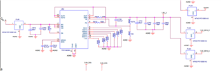

  • Hi Nick
    I am attaching the schematic.
    Input voltage is 5V and output voltages are 3.3V and 1.8V. Current is lesser than 1A.

  • Hi Vikas,
    I'm a little confused by what you said. You said that after removing the capacitors, the VREF was 0.79V to 0.8V, which is what it should be. It seems to me that this solved the issue. Which capacitors did you remove for this test? Other than the BIAS capacitor (which I explain in the next paragraph), I don't see an issue with the capacitors in the schematic.
    One thing I see in the schematic is that the BIAS pin does not need a capacitor to GND if BIAS is not used. It should be left floating. I don't know what the consequence is of having the capacitor there because the datasheet does not specify, but it would be good practice to do as the datasheet says.
    Another potential concern is the thermal performance. 5V -> 1.8V @ ~1A (I don't know how much current your application actually uses but you said the load current is less than 1A) is over 3W of power dissipation, so this has the potential to be getting the device close to thermal shutdown if the layout has flaws in regards to on-board heatsinking. Can you share a screenshot of the layout near the device?
