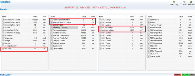

This is Brian, I am writing to check with you about the SOC jump for BQ4050. Here are the details:
  • My customer uses BQ4050 as the solar monitor, which charges during the day and discharges during the night.
  • The cell they used has the function of heating mechanism, which begins when the core temperature is less than -3 °C and stop heating at 9 °C. Up to 6~7 heating movements may occur during the day.
  • The SOC jump always occurs when it is sunrise to start charging, SOC can jump from a lower charge (3% to 80%) to 100%. And at that time the voltage is generally higher, about 8.1V ~ 8.4V.
  • And also when the sun goes down, SOC can also jumps down occasionally, the jump value is usually the charge value of the sunrise charge time.
  • The jump always related to the temperature. It mostly appears when the temperature is below zero or it changes from above zero to below zero .
The attachment is partially abnormal data.

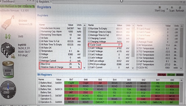

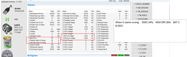

    1.  I checked with my customer again and here is a clear register.
    It shows the registers before the jump, the Max Error is 26% and the Relative State of Charge is 34%.
    But after the jump, the Max Error will jump to 100% and the Relative State of Charge will jump to 99%.
    Other registers have no changes observed.

  • Hello Brian,
    The Max Error should really only jump to 100% if there is a device reset, do they perform any resets in their host code now? When a reset is performed on the BQ4050 it will use the voltage to correlate to a SOC value and MaxError will go to 100% automatically.
    Cycle Count would indicate SOC jump after aging, but not jumps of Max Error to 100%.
    You could issue another reset command after the voltages are relaxed, but this will still cause max error to go to 100% until FCC is updated.
    Yes the CEDV profile that they uploaded from the GPCCEDV tool will impact how the RSOC changes near EDV. But I don't believe it is related to this case since RSOC is going up, not down.
