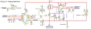

    I came up with other issue regarding avalanche mode of Mosfet for TPS1213 applications. As you know, when the Mosfet will switch off, due to inductive load characteristics and wire harness inductance, clamp circuit is required to limit Mosfet Vds and keep the junction temperature of Mosfet inside the safe operating area. However for high current load (160-250A) I couldn´t find a proper TVS and several parallel TVS is required that cause some other issues.
    I did a simulation and the preliminary results shows that if we put a TVS (Ex. 24V) between drain of N-Mosfet and G1PD (tha is also connected to G1PU) it can clamp the Vds voltage with low power dissipation in TVS.

  • Hi Navid,
    I see that your input and output inductances are not that much. Major part is coming from the load inductance. Have you considering any freewheeling path at the output during inductive load turn-off
    Can you share your schematic to look at
    Best regards
    Rakesh
  • Hi Rakesh,
    Regarding input and output inductance, sorry, I made a mistake. For one of our outputs with 4m wire length the output inductance is about 6uH.
    No we don´t have freewheeling path at output load (schematic below).
    We are thinking to use unidirectional TVS in parallel with MOSFET (also a rectifier diode in series with TVS to block the current in reverse voltage).
    But we are not sure it can survive MOS in avalanche mode? Maybe several TVS should be used in parallel.
    PS: Using TVS between drain and G1PD IC pin cannot be a case to tackle this issue?
    Any issue please let me know,
    Navid
  • Hi Navid,
    Can you share higher resolution image.
    What is the purpose of FET between output and SRC?
    Best regards
    Rakesh
  • Hi Rakesh,
    Please check link below for a probable higher resolution image (I couldn´t use the insert button to provide a high resolution image, I don´t know how I can send you a better quality pic).
    The purpose of P-FET mosfet is to make the main mosfet enable in reverse voltage (as it proposed by you in a meeting we had some weeks ago).
    /resized-image/__size/320x240/__key/communityserver-discussions-components-files/196/QMC.JPG
    Navid
  • Hi Navid,
    In case of parallel MOSFET configuration, the Vds clamp solution of placing TVS diode between Drain and GATE of the MOSFET may not be a good option. The mismatch between the parallel MOSFETs will lead to unequal power stress and can damage the MOSFETs.
    Using TVS diodes 5.0SMD type at the input and schottky diode (similar to SBR10U45SP5-13) at the output would be better options.
    Best regards
    Rakesh
