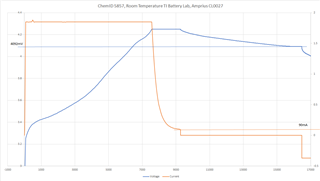

  • TI actually charged to a taper current of 90mA (not 900mA). So while this is good as it's close to your setup, the cell behaves differently.
    TI battery lab:
    Note how cell voltage settles at 4092mV.
    This is different from your roomtemp.csv file:
    Here it settles at 4215mV. Note that it started out at 4068mV. Then you charge 250mAh, which results in 4215mV relaxed OCV. Total discharge capacity for your log file is 7400mAh, which indicates that your are using them in a 6s2p configuration. Is this correct?
    If it's a 6s2p configuration, then 250/2 mAh = 125mAh of charge results in a significant change in OCV (4068mV to 4215mV). 125mAh is 3% of Qmax (100 * 125mAh/4008mAh) so it looks like these cells have a really steep OCV curve at low DOD and our characterization doesn't cover quite the max. OCV that you reach by charging to an effective 90/2mA = 45mA taper current.
    --> This looks negligible. Also, for better accuracy, GPCRb requires a complete charge, not just a 3% charge like in your example. If you re-submit this with room temperature log data starting with a fully discharged cell and a charging phase to full with an 180mA taper current (if you use a 6s2p pack), then I anticipate that the tool will not throw an error. Also make sure that the discharge log doesn't have a spurious measurement of 0V (like in your existing roomtemp.csv file).
