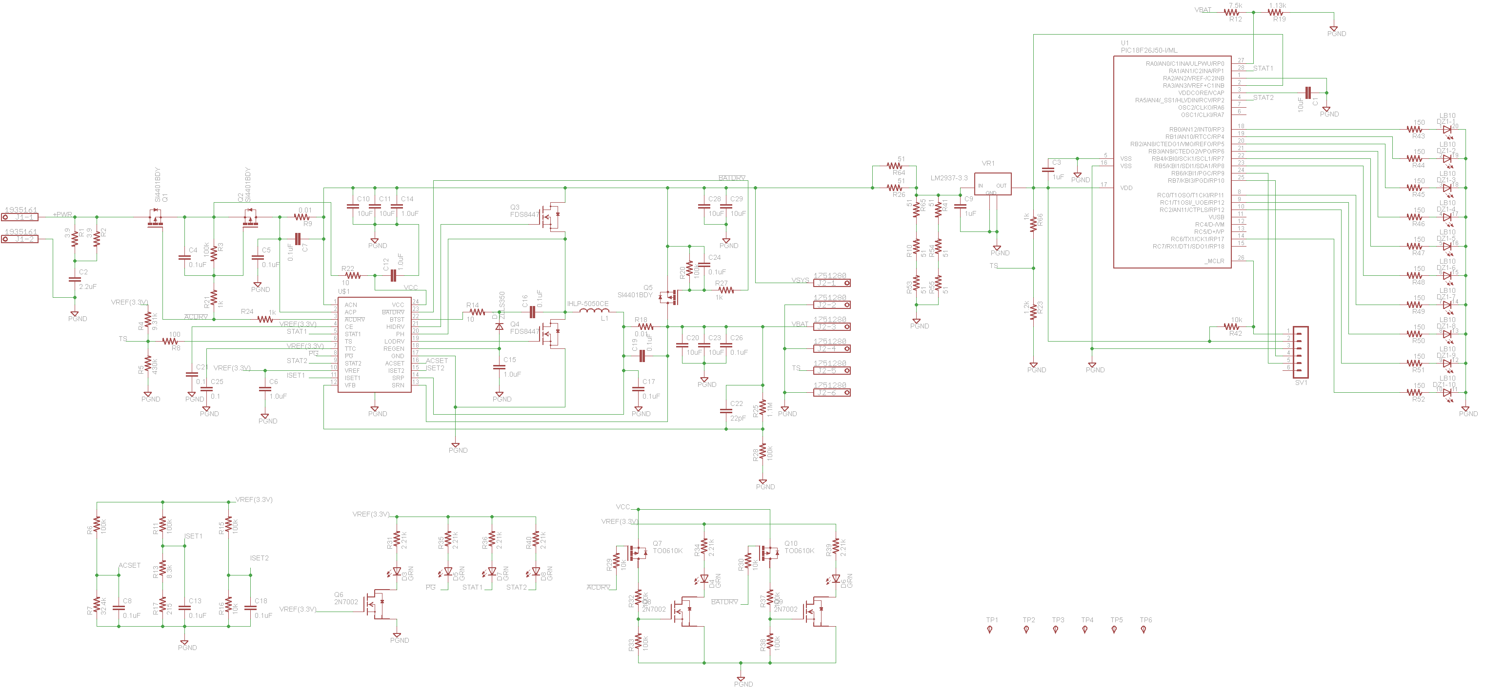

I'm working with a bq24610 and am getting unexpected values on the STAT1 signal. When the battery is disconnected, both STAT1 and STAT2 should be low. Howevery, when I run the board with a load on VSYS and the battery disconnected, STAT1 goes high. As soon as the VSYS load is disconnected, STAT1 goes low. So I'm thinking that the signal from VSYS is leaking through the BATFET causing the chip to think there is a battery on VBAT. Any idea if this is right or what else could be the issue? Thanks.

  • It will be hard for me to remove the BATFET. But I've attached the schematic of the board. Can you please take a look and let me know if anything is wrong? For the most part it's the EVM with configuration changes to the cell count and charging current. We also have a separate circuit coming off of VSYS.

    Do you see anything in my schematic that is incorrect? Could the extra circuit coming off VSYS be causing a problem? It's the only difference I can see between my board and TI's EVM (other than resistor configuration values).
  • Is the STAT1 still wrong? I didn't find something wrong in the schematic. It is very close to the EVM schematic.
