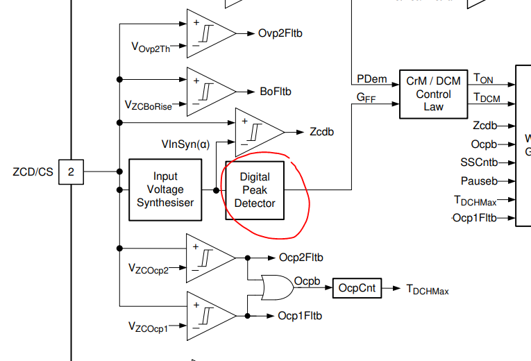

  • Hi Ray,
    1.  I assume the feed-forward voltage is being compared at this peak detector,

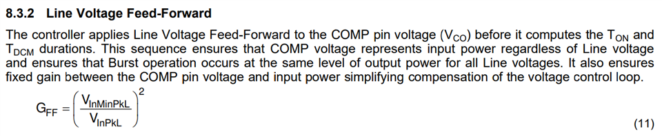

    before any switching, since the Vin is exactly the ZCD voltage. does that mean ZCD has to sample through out whole 60Hz cycle( or maybe half) to know the peak input voltage(ex.230V) and decide the correspond GFF?
    2. as for second question, it said before it decide the correspond  GFF, it will apply VFF to COMP voltage(Vco),
    but I don't really get what it means in the datasheet, would you elaborate why does it apply VFF to Vco?

    Q1: The digital peak detector will need to sample anywhere from half up to the entire line cycle. It won't recognize the highest reading as being the peak until it sees a zero crossing (then it will know the previous max voltage was the peak of the just-completed cycle).
    Q2: That sentence in the datasheet is misleading due to poor wording. The line voltage feed forward is not applied to COMP, but VCO and VFF influence TON. By making the gain of the loop inversely proportional to the square of Vin cancels out the influence of the line from the loop.

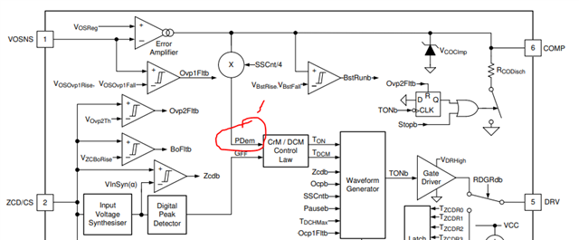

    so you mean the Vco acutally represent the square of Vin part,
    I saw there're PDem and Gff before the the Ton/TDCM, does that mean PDem is the square Vin part you mentioned that from Vco?
  • Hi Fred,
    PDem is proportional to Vin^2 where Gff is proportional to 1/Vin^2
    Ray

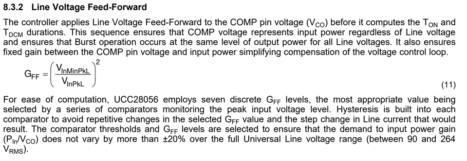

    1. I know GFF will be fixed at very beginning when you can directly sense Vac by ZCD/CS pin,
    but I wonder if PFC operate normally for a while, then the Vac increase from 110V to 264V,
    will the Ton/Gff change accordingly or it will be still and fixed?

    1. GFF/TON will update when the input voltage changes per the VFFxRise and VFFxFall thresholds.
    2. Both PFC controllers were designed to work over the Universal voltage range of 90-264Vac. The UCC28056 uses discrete levels for determining Ton (starts with Max TON for lowest VIN. As VIN increases, TON decreases to maintain same power envelope). TON for the UCC28064A is analog (does not use discrete levels) and can be shifted though selection of RTSET. However, this wouldn't result in a limitation at high Vin.

  • Hi Fred,
    I'm hoping this will clarify the relationship between Vin, GFF and TON:
    • Vin is rectified by the bridge.
    • Vrec is the average rectified voltage over a line cycle.
    • Due to Volt-second balance across the inductor, Vrec = average voltage at MOSFET drain.
    • The line voltage information is obtained by filtering this drain voltage with a low-pass filter. Thus, VinSyn(a) is a divided signal of the rectified voltage. with a small phase shift due to the filter.
    • VinSyn(a) is fed into a peak detector and that information is used to calculate GFF.
    • GFF limits TONMAX based on Input voltage.
    Ray

    1.so I would take it as yes that GFF will change during the operation according to the Vrec if we increase the Vac rms value, right?
    2. but the difference is during startup stage, the Vinac is sense directly through inductor instead of rectifying and synthesized,
    since there's no current flow through inductor at that time, right?
  • 1. Correct.
