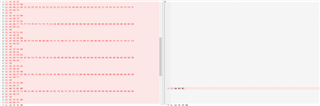

  • I'm sorry, but I'd like to ask you again to confirm that the following chart shows the result of comparing Ecmm with the Fs file we used at the beginning
    Will the new Subclass IDs 53(block00\01), 54, 55, 68(block00\01), and 69 be changed after the fs file is loaded and the fuelgauge IC is running?
  • I can't determine anything from these two compare screenshots. They just show that two check-sum compares are different, which is expected. Also the right side doesn't have the calibration info.
    0x53, 0x54, 0x55, 0x68 will stay constant. 0x69 will not stay constant (CC Offset will/may change when the gauge runs auto-offset calibration).
