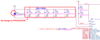

Q1: For calculation Vin power consumption is about 12V, 2.81A
Want to confirm is it ok to use 3x10uF 0603 & 2x0.1uF 0402 for Cin capacitor.

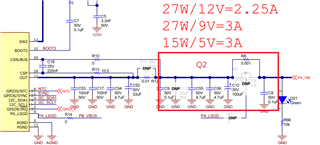

Q2:By reference TPS25762EVM-146 schematic, What’s the purpose for R8 0.001 ohm resistor?
Want to confirm is it ok to use one 0.01 ohm 2010 for shunt resistor + 3x10uF 0603 & 1x4.7uF 0603 & 2x0.1uF 0402 for Cout capacitor.

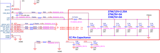

Q3:What’s the purpose for pin:9 PA_LSGD?
If not used how to deal with this pin?
Q4: GPIO5_NTC is not used, will pull-down with 4.7K ohm resistor
Below six pins were not used, is it ok for floating?
PA_PD_GPIO8 left floating
PA_PM_GPIO7 left floating
GPIO0_HPD left floating
GPIO1_IRQ2(0) left floating
GPIO6_SYNC left floating
GPIO9_IRQ_N left floating

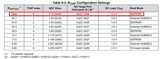

Q5:
For online send register bin file from MCU to EEPROM via TPS25763-Q1 I2C2
Should it required to have online TVSP index selection control 0~8?
Or could we just left RTVSP OPEN for fix with index 0?
if any suggestion, Please advise me.

    1. That's fine. See Section 7.4 in the datasheet
    2. R8 is simply a 0-ohm resistor used to bypass the DNP'ed MOSFET tied to pin 9.
      1. Regarding the 10mΩ resistor, ensure it is with 1% tolerance. 2010 case is fine.
      2. See Section 7.4 in the datasheet. C_BUS should range from 100~150uF.
    3. Pin 9 can be used as a charge pump output for external NFET for V_BUS bulk capacitance blocking. You can leave it as a N.C. if not used.
    4. If NTC is not used, yes, you can use that pull down resistor. If any of the GPIO pins listed are not used, leave it as N.C.
    5. If you do not need other options aside from Index 0, yes, you can simply leave RTVSP as an open. But ensure the recommended components under Table 9-2 in the datasheet is followed.

    Seong has a very good answer about your questions, one more point need to add, for your question 5, when you want to update the firmware using MCU send to EEPROM, you need to set the TVSP index to 1,3,5,7, when you finish to update the firmware, you can set to index 0 again, and re-power our device, then the new firmware will be loaded in our device from the EEPROM.
