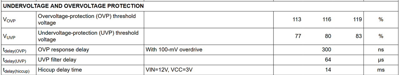

Hi ,
I checked DS and the device UV protect behavior should be hiccup, but look into section 7.3.10, the behavior is latch off.
My I have your clarification on the UV behavior?
Hi Jim,
Sorry for the confusion caused.
The UVP behavior is hiccup.
The FETS are turning off after being filtered for 64 uS.
But then if under voltage condition no longer exists, after 14mS the device will restart.
Hope this helps.
