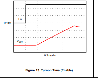

  • Hi Ishiwata San
    The behavior of Enable pin startup is given in figure 13 (page 8)
    What is your turn on settling tiem ?

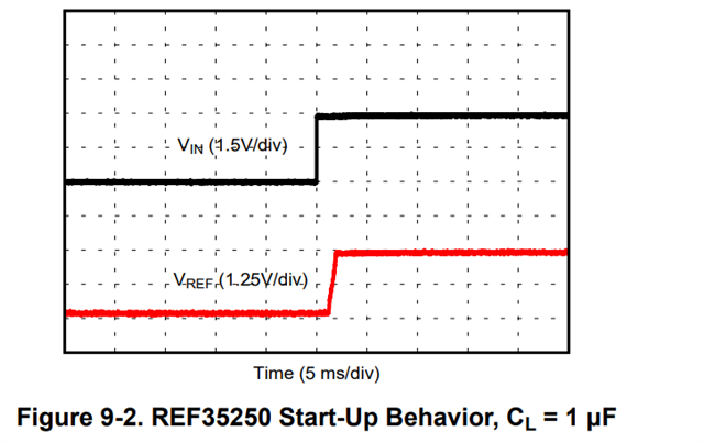

    REF35  doesn't have any oveshoot. If you are specificly concern about overshoot.
    Trailokya

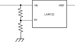

  • Hi Trailokya,
    Thank you for your reply.
    I understand that even if EN is input after VIN is input, a slight overshoot will occur.
    The customer is inputting the input to EN with a voltage divider resistor as in the circuit below.
    Overshoot occurs, but is there any particular problem with how the device is used?
    Ishiwata
  • Hi Ishiwata
    • Thre will not be any problem with the overshoot. The device will work normaly.
    Why you are using a resistor devider with EN pin?  You can diretly short wit with EN pin. Extra resistors will burn some current?  Can you please tell the values of the resistors.

  • Hi Trailokya
    Confirmed to my customer.
    The assumed resistance value is 30kΩ on the VIN side and 20 kΩ on the GND side.
    The reason for inputting to EN by resistance division is as follows.
    Because it delays the input to EN. I want to make the rise slower than VIN.
    I will always appreciate your kind support.
    Ishiwata

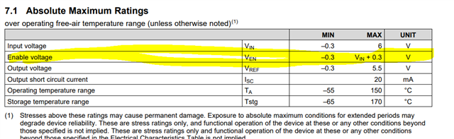

  • Ishiwata San
    Thanks for your confirmation.  This should work fine. This should work fine if VIN is >=4.0V as EN ris is 1.6V.
