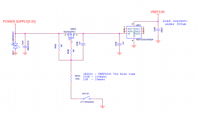

Is there a restriction on the rise time of the input power?
Most operate normally regardless of VIN rise time, but Only one has an VOUT  No Output, HIZ phenomenon.
The datasheet does not show anything regarding the VIN rise time.
Should I regard it as a chip defect?
OSC CH2: VIN, CH3:VOUT
1.VIN = 3V, Rise time : 100msec  -> VOUT  No Output, HIZ
2. VIN = 3V, Rise time : 10msec  -> Good work
