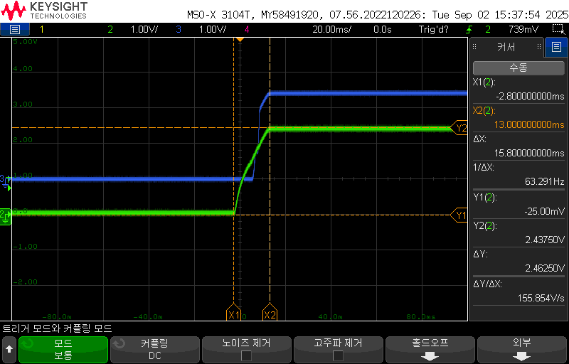

When I checked the defective parts, they are reproduced according to the VIN's Rise time and are as follows.
[Defect phenomenon waveform]
CH2: VIN, CH3:VOUT
VIN = 3V, Rise time : 116msec -> VOUT No Output, HI-Z
[Good waveform]
VIN = 3V, Rise time : 15msec  -> VOUT (Good work)

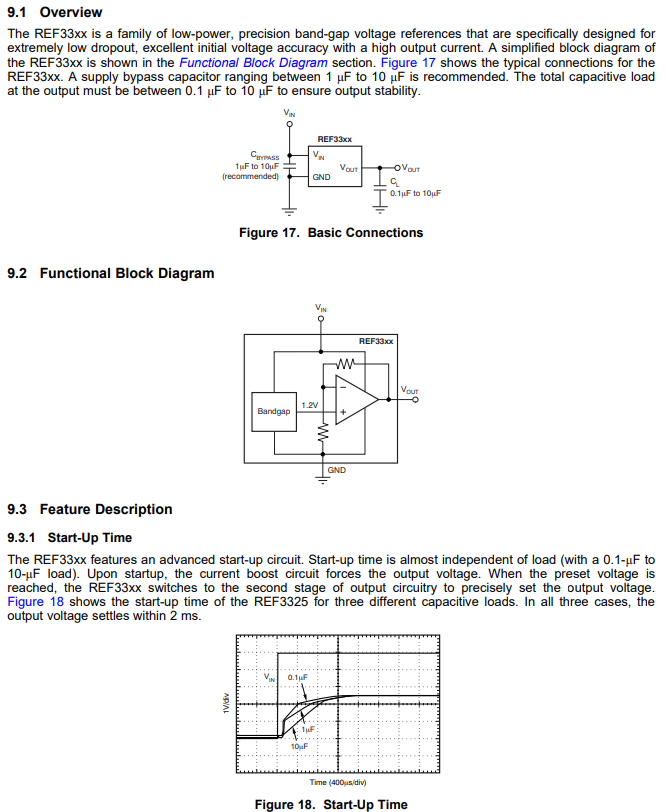

Q1) Will there be any impact due to the raise time of the Vin of REF3330? Are there any restrictions or requirements based on the raise time?
Q2) Are there any other expected causes?
3) Should we report the above phenomenon as REF3330 defect and proceed with defect analysis? (The defect phenomenon is 1ea occurrence, and the rest of the parts are operating normally)

    In addition, Cbypass (1uF~10uF) on Vin side is recommended on Datasheet, but I checked with the customer and they applied Cbypass (0.1uF). Will this be a problem, too?

    Please have the customer test again with the recommended bypass capacitance to see if the behavior is any different. We will also take a look at the device ourselves to see if we observe any abnormal behavior.

  • I was not able to observe any abnormal behavior of the device with slow VIN rise times. At this point, it is up to the customer to decide how they would like to continue.
