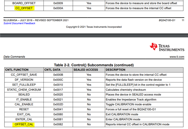

we are going to calibrate a bq34z100G1 with our own software tool during production. It is not clear to me which commands we have to send. In the TRM we didn’t find details for the process. There are only some short information for the commands.
The calibration procedure of CC Offset in Battery Management Studio takes around one minute. Could you please help us to clarify which commands there are sent.
Thank you for your help.

  • Hello Stephanie,
    This should outline all the steps for manual calibration.
    2. General Processes
    2.1. CC Offset
    The CC offset calibration is mostly done by the gauge, we just need to poll the CCA bit until it is complete.
    General procedure:
    1. make sure CAL_ENABLE is set, if not enable it: 0x002D
    2. Send the ENTER_CAL command: 0x0081
    3. Send the CC_OFFSET command to begin the process: 0x000A
    4. Pull the CCA bit until it clears (can take some time to clear, up to a minute possibly): CCA can be read from the CONTROL_STATUS command, 0x0000, high byte, bit 3.
    5. When CCA clears, send CC_OFFSET_SAVE: 0x000B
    6. Send EXIT_CAL: 0x0080
    7. Send CAL_ENABLE again to exit calibration mode: 0x002D

  • Hello Wyatt,
    thank you for your detailed explanation. One more question:
    What is the difference between OFFSET_CAL (0x0082) and CC_OFFSET (0x000A).

  • Hello Stephanie,
    Both of these are defined in the TRM.
    Sincerely,
    Wyatt Keller
  • Hi, I have seen that. But it is not clear to me what that mean in Detail.
    Best regards
    Stephanie
  • Hello Stephanie,
    OFFSET_CAL reports the offset in calibration mode. CC_OFFSET actually instructs the gauge to perform internal CC offset calibration.
