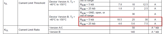

From the TPS2HB35-Q1 datasheet, I know that ICL=KCL / RILIM.
For B version, the KCL = 140 A* kΩ.
From datasheet, when RILIM = 25 kΩ, the ICL = 140/25 = 5.6A which matches the typ value in datasheet.
But when RILIM = 5 kΩ, the ICL should be ICL = 140/5 = 28A. But the typ value in datasheet is 25A.
Could you please help explain why there is such a difference?

  • Jeff,
    You can actually use any resistor value in between and set a custom/tailored current limit to your application. In general for our high-side switches, the lower-Ron devices will be more accurate at higher current limits.
    We provide a calculator tool that will account for all accuracies/tolerances for our HB device current limits below. I recommend using this:
    https://www.ti.com/lit/zip/slvrbg2
