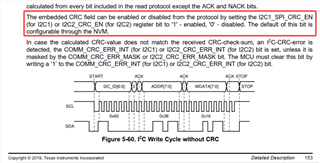

Hi TI experts,
Can PMIC I2C CRC be disabled by writing REG after I2C_CRC is enabled?
Or if we expect that PMIC I2C CRC can be disabled, what are the other ways?
Note:We try to disable PMIC I2C CRC by write the following reg, and it is not work, please help to confirm
