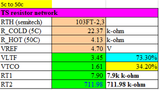

We are currently using the battery charger IC BQ25601RTWR in our design that is used to control the charging and discharging of a 1500mA Lithium ion battery.
we wanted to control the temperature at which the charging is cutoff from 5degC to 50degC but the datasheet only provides the range details from 0degC to 60degC.
the TS pin resistor divider calculations where done for 5degC to 50degC we got the resistor values as 4.7K and 30k
the values for the calculation have been taken are as follows.
VREGN=4.7V
VT1-73.3% of VREGN
T1 (0°C) threshold, Charge suspended T1 below this temperature. Charger suspends charge. As Percentage to VREGN
VT3- 44.7% of VREGN
T3 (45°C) threshold, charge back to ICHG and 4.05V above this temperature. Charger suspends charge. As Percentage to VREGN
BATTERY DETAILS
RTCOLD(5C)- 22.37
RTHOT(50C)- 4.27
RT1-4.7K (APPROXIMATE VALUE)
RT2-30K (APPROXIMATE VALUE)
CALCULATIONS DONE:-
are the above values correct for this calculations of setting the charging temperature range from 5degC to 50degC or have we missed anything?

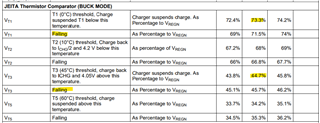

Also wanted to clarify some value details in the below table.
1)is the below table a standard that we have to follow or will the values vary for different temperature.
2)what does falling in the second column mean?
3)to change to 5degC to 50degC from 0degC to 60degC what are the percentage values that have to be used.
4)what does VT3 state mean for the battery(whether it will charge till the voltage is upto 4.05 and later stop charging or will the charging cutoff when it reaches the temperature,independent of the voltage ?)

    Thank you for reaching out via E2E. The resistor values you calculated are correct to make the TS cold threshold (T1) =  5degC and the TS warm threshold (T3) = 50degC.
    Based off the description provided in regards to cutting off charge above 50degC it appears you are instead trying to make the TS hot threshold (T5) = 50degC. To make this adjustment please change the VT2 value in the calculation tool to 2.10V (34.2%).
    Unfortunately, Given the thermistor values associated with 5degC and 50degC you provided there does not exist a resistor divider network that meets the thresholds you are looking for. The closest solution I found is 0degC to 50degC, which can be achieved with RT1 = 7.896 Kohms and RT2 = 105.5 Kohms. Feel free to check if other thresholds close to 5degC to 50degC can be achieved.

    1) The table attached from the datasheet is the standard the BQ25601 will always follow. The temperatures associated with each threshold (0degC, 10degC, 45degC, and 60degC) are valid assuming the recommended 103AT-2 thermistor and RT1 = 5.23 Kohms and RT2 = 30.9 Kohms are used.  Using different resistor/thermistor components will adjust the temperature value, but the threshold values in the table will not change.
    2) The rows with the description falling are provided to show that there is hysteresis associated with each threshold. For example, when the TS pin voltage is rising, signifying temperature is dropping, charge will be suspended when TS voltage crosses Vt1 threshold (73.3%). Then when the battery temperature rises charge will be resumed when TS voltage falls below Vt1 falling threshold (71.5%).
    3)Answer to this question is mentioned above. If you desire charge to be suspended outside of the range of 5degC to 50degC then the percentage values used in calculation should be 73.3% (VT1) and 34.2% (VT5).
    4)TS voltage in the range between VT3 and VT5 (nominally 45degC to 60degC) is considered a warm battery. JEITA guideline recommends the battery only be charged up to 4.1V instead of the normal regulation voltage set via VREG register (default 4.2V).

    1)I have actually calculated with the VT1 and VT5 percentage values that you have stated above and got the below resistor values for the range of 5C to 50C could you please confirm whether this is accurate.

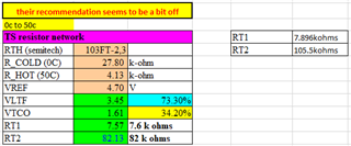

    2)also calculated for the range that you have suggested and I have seen a mismatch in the resistor values, would like to know the reason for the mismatch?(below table shows the calculation)I think the thermistor which you have taken as reference is different from the one which we have taken.

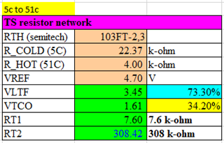

    =>we have tested with the resistor values RT1=7.68k and RT2=309k (closest values)Which is supposed to cutoff for the temperature range from 5degC to 51degC as per the calculations.
    we see that the charging get cutoff at 5degC lower side but higher side does not cutoff even when the temperature is above 60degC(battery case temp around 54degC). and also after some time it starts to charge again even when the temperature is constant(time duration kept for charging is around 4 hours)
    do you have any inputs on this observation since we expect it to cutoff at 51C.

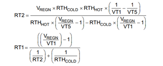

    After doing additional research into the TS resistor network on this device I found that the range from Cold to Hot needs to be a minimum of 50degC for the device to function as expected. Therefore the various resistor networks for 5degC to 50degC are not viable options.
    1) I have confirmed that the resistor values you calculated mathematically work. My initial calculations showed a solution did not exist when NTC value at cold and hot = 22.37 Kohms & 4.27 Kohms respectively to match the table you initially provided. Although, this solution will not function as expected.
    2) The difference between your calculation and the one I provided is the values used for NTC hot and cold. I calculated RT1 = 7.896 Kohms and RT2 = 105.5 Kohms using R_COLD = 27.28 Kohms (0degC value from 103AT datasheet) and R_HOT = 4.27 Kohms (49degC value from your original calculation table).
    I have checked both sets of resistor values and the behavior on the device should be similar using either solution.
    3) The range from Cold to Hot needs to be a minimum of 50degC for the device to function as expected.
    I recommend switching to either your solution or mine for 0degC to 50degC range. You can also try a solution for 5degC to 55degC temperature range if that fits your requirements better.
